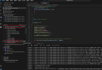

I have a MIMXRT1180-EVK board, and my IDE is MCUXpresso for VS Code, the SDK version is 2.16.000, J-Link is used, JP4 is shorted. I have questions about debugging.
First, SW5[2:4]=001, the "evkmimxrt1180_rled_blinky_demo_cm33" work well using the "debug" build configuration, I can download and debug the demo code, and the "D6" LED was blinking. But it can't work after power on again.
Second, SW5[2:4]=100, I can download the blinky demo using "flexspi_nor_hyperram_debug", but can't debug it. The breakpoint in the main() can't be reached. I don't know why.
Third, I open the "vkmimxrt1180_rled_blinky_demo_cm33\armgcc\flexspi_nor_hyperram_debug\rled_blinky_demo_cm33.elf", find that it is start from 0x28000B00. And the "vkmimxrt1180_rled_blinky_demo_cm33\armgcc\MIMXRT1189xxxxx_cm33_flexspi_nor_hyperram.ld" show that the app_image_offset is 0x0000B0000.
Why does the image not start from 0x28000000?

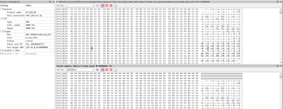

Fourth,  after power on again, I readout entire flash using J-Link, and I find that the content start from 0x2800B000 is same with rled_blinky_demo_cm33.elf. And the content between 0x28000000 and 0x2800B000 is 0xFF.
Can you help me? I want the code startup after power on again.

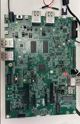

shengs
Can you use J-Link to test again?
The JP4 and JP5 is shorted on my board.

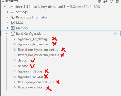

shengs
是的,我使用Jlink的情况下只能在“debug”或者“release”模式下调试,其他所有模式都不行。你这边也是这样吗?我最终目的是想在flexspi_nor和flexspi_nor_hyprram模式下使用Jlink能正常调试,且板子重新上电后点灯程序能正常启动。
6,705件の閲覧回数
Harry_Zhang
是的,如果使用jlink,目前Vscode中只能在“debug”或者“release”模式下调试。如果您想板子重新上电后点灯程序能正常启动。建议用板载debuger。
Hang
6,694件の閲覧回数
shengs
如果使用J-Link,如何才能使用其他带flexspi的模式调试、重新上电运行?之前说过,我们的项目组期望真实产品的开发过程使用J-Link。谢谢!

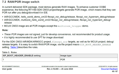

shengs
原因找到了,是XIP_BOOT_HEADER_ENABLE没有使能,见"MCUXpresso_SDK_V2.16_MIMXRT1180-EVK_Repository\docs\Getting Started with MCUXpresso SDK for MIMXRT1180-EVK.pdf"
对于MCUXpresso for VS Code,在evkmimxrt1180_rled_blinky_demo_cm33\armgcc\flags.cmake文件里更改。
6,462件の閲覧回数
Harry_Zhang
Hi @shengs
是的,您说的是对的,如果需要从flash启动,这个XIP_BOOT_HEADER_ENABLE是需要使能的。
感谢您提供的信息。
Hang

shengs
对于MCUXpresso for VS Code,使能XIP_BOOT_HEADER_ENABLE可以使flexspi_nor_模式的代码上电启动,但是仍然不能调试。
