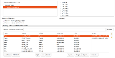

I have split up the flash memory in 3 parts:
The BOOT_FLASH at 0x60000000 contains the boot and dcd data. The secondary bootloader is located in START_FLASH and the main application is located at 0x60006000.
