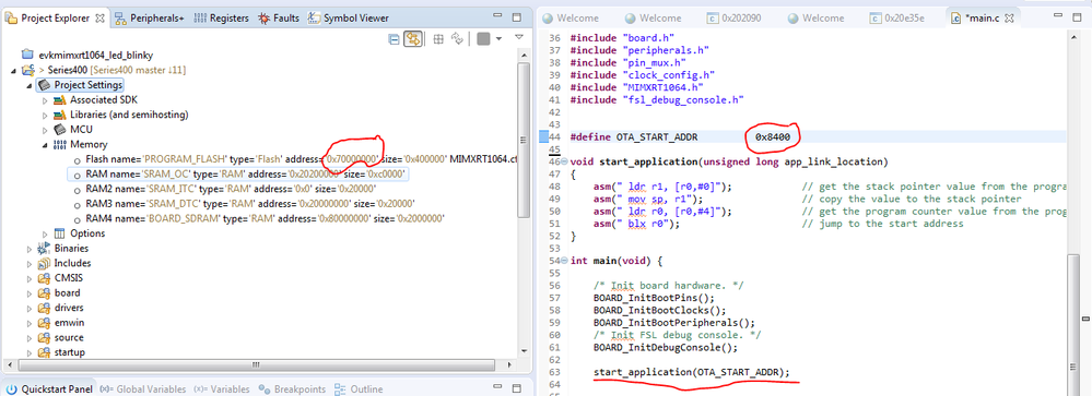

In the main.c (Secondary bootloader), I have written the code shown below.

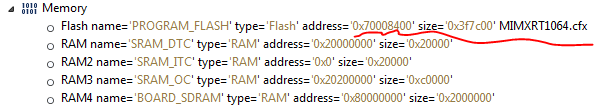

Here, the LED blinky code from SDK is used as application code. I have modified the memory configuration in application code as below:
I am expecting the primary bootloader is jumped to secondary bootloader(by default) and then the secondary bootloader will jump to application code. So, when I write bootloader binary at 0x70000000 and application at 0x70008400 location using GUI flash tool, the application should run (should blink the LED).

The secondary bootloader that we provide with the SDK is only available to run in RAM memory, are you modifying this bootloader to boot from flash? I saw in your images that you actually have a different main file from the one that we provide. Could you clarify how do you set the change of from Flash to RAM, in order to program the hyperflash?

I have two separate projects, one is a bootloader project and another is an application project.
Right now the bootloader code has only main() and inside that, we have written jump to application functionality.
I am writing the bootloader binary first at the default location 0x70000000
and writing the application at 0x70008400 by setting the base address in the GUI flash tool. (Please correct me if I am doing wrong).
I have added IVT and related data in the secondary Bootloader only started at memory location 0x70000000.
I have not included the  Image Vector Table (IVT) in the application image.
The end target is the primary bootloader will call the secondary bootloader by default (stored at address 0x70000000) then the secondary bootloader will call the application starting from memory address 0x70008400.
