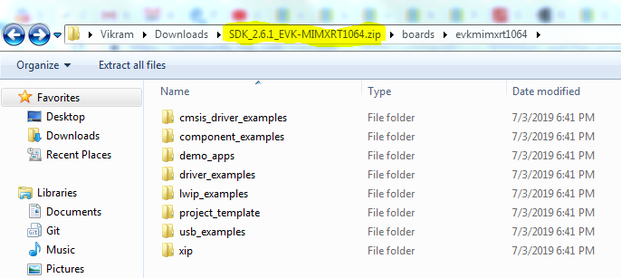

I did not find the bootloader_example code in the SDK library. Could you please provide me the SDK link and the name of example code or path of example code in the SDK?
I am using MCUXpresso IDE v10.3.0 [Build 2200] [2018-12-03] and "SDK_2.6.1_EVK-MIMXRT1064" SDK. So, do I need to upgrade the IDE for this issue?
Vikram

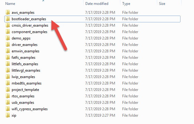

jeremyzhou
Hi Vikram Tathe,
Thanks for your reply.
Please find the bootloader_examples as the Fig 1 shows.

vikram_tathe
Hello jeremyzhou
I did not find the bootloader example code in the SDK (SDK_2.6.1_EVK-MIMXRT1064).
Could you please confirm that your SDK is the same as mine?
If it is different SDK for imxrt1064 then please share the SDK link.
Vikram

jeremyzhou
Hi Vikram Tathe,
Please choose the Select All when building the SDK library.
TIC
