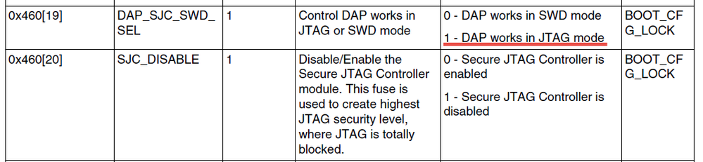

jeremyzhou
Hi leonardo salvatore,
Q1) Will it make possible to use the challenge/response mechanism with SWD?
-- Actually, I'm very clear with the question, whether you can clarify it.
Q2) Does it work only with JTAG so I need to disable the SWD entirely?
-- Yes, you can disable the SWD mode by setting the DAP_SJC_SWD_SEL bit.
