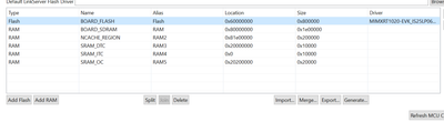

I am trying to reconfigure my project to have global data placement in the SDRAM, I am using mx rt 1020 board. I define XIP_BOOT_HEADER_DCD_ENABLE = 1 and SKIP_SYSCLK_INIT and the project compiles just fine and I can see that global variables are placed in the SDRAM. I also configure the MCU settings as in the picture below:

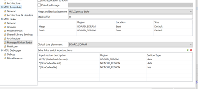

And my configurations for the linker script page:
I am able to begin running the program. The problem is that the program halts when I lpi2c_rtos_init is called within BOARD_InitPeripherals. Specifically, when it tries to generate mutex / allocate memory. The program gets stuck in the xTaskResumeAll function since the function call doesn't match the previous call to vTaskSuspendAll. I am obviously missing something in my configurations, but am having a hard time figuring out exactly what that could be.

Hi @tbtbtbt ,
This problem may caused by SDRAM cache feature. You'd better put heap in noncacheable area. You can assign part of SDRAM space to be noncacheable in BOARD_ConfigMPU().
Jing

tbtbtbt
@jingpan
I was able to follow your advice and this post to make it work.
