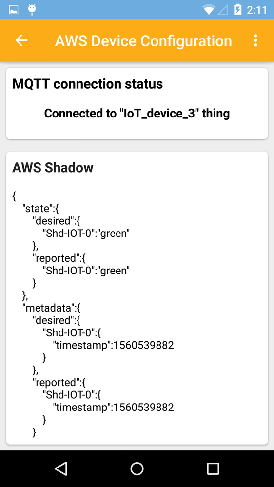

I followed the instructions stated on readme file of "evkmimxrt1060_aws_device_configuration_enet" example project to create AWS account, flash the image into i.MXRT1060 and load the Android appl into the Nexus phone. The phone is able to find IoT device (i.MXRT1060) and configure the flash (ex: thing name, cert and private key …) if not done yet. After successful configuration, IoT device (i.MXRT1060) is able to connect with AWS cloud and update the shadow periodically. Afterward, I ran the MQTT/shadow demo on the phone which reported MQTT connection error after time out. May I know what could be wrong in my setting?

After many iterations of try/error with info obtained online, one of many smoking guns happens to be the right one. The problem is what stating on this “readme” file is not totally correct. For example, step 7 to prepare the preference file is stating ==  “customer_specific_endpoint=<ACCOUNT ID>.iot.<REGION>.amazonaws.com”.
Instead of ACCOUNT ID, it should be your targeted THING API endpoint ID. With it corrected, MQTT is connected and device shadow is accessible. No further action is required from your end. Many thanks for your attentions and supports in the past.

As stated as step #8 on "ReadMe.txt" file, " 8. To run Android application do either:
a) install and run pre-build apk on Android device (<SDK_Repository>\boards\<board_name>\aws_examples\remote_control\android\AwsRemoteControl.apk)
b) open project in Android Studio, build it, attach Android device and Run application"
The actual directory is "\SDK_2.5.0_EVK-MIMXRT1060_MCUXpresso\boards\evkmimxrt1060\aws_examples\device_configuration_android" which is different.
I do believe some AWS setting might be wrong. I can't be sure MQTT client connection should work in un-authentication role registered under Congnito. I also suspect whether this demo could run with mini Android sdk version of 21 (for Lollipop). Below is the picture of Android appl as you requested. "MQTT connection status" will display as "error" after time out. Let me know if you need further information to duplicate/debug this issue?
