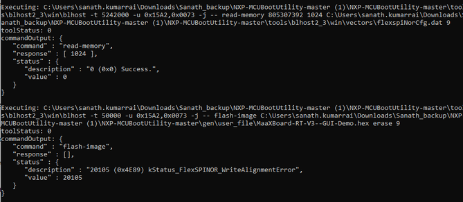

We are trying to flash the Hex file generated into our board which has MIMXRT1176DVMAA controller using NXP boot utility tool.
Its giving an error as FlexSPI write alignment error.
But the bin file of the same application can be loaded and is working fine.
What might be the issue?

To be prudent, I was wondering if you can share the log of the NXP boot utility V3.5.0, further, please illustrates the steps of generating the hex file.

1. Below is the Log from NXP boot utility.

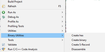

2.I am converting the .axf file to .hex file from MCU Xpresso Binary Utilities option .
the .bin file which is being converted in same way is working when we dump using NXP boot utility.

Hi @S_Rai ,
Thanks for your reply.
Actually, you need to adjust the linker file and modify related macros prior to generating the axf, so please refer to the post.
