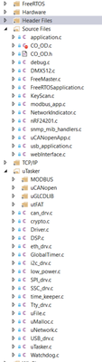

mjbcswitzerland
Specialist V
Vlad
Details are here: https://www.utasker.com/Licensing/License.html
whereby code is shared on a private GIT server.
Depending on the plan the project is free for commercial use as long as support isn't needed or full time e-mail and remote desk top support during 3 or 12 months is included in the paid commercial plans.
There is a framework and applications. All applications share the framework but each application configures it for their own use. Usually it is not necessary to make changes in the framework (but can be edited if needed). This video shows how custom applications are cloned/added to the framework so they can have their own independent Git repository too: https://youtu.be/_7Rxdr0NKWE
Attached is an i.MX RT 1024 binary (it can be loaded using NXP MCU Boot Utility - see chapter 4 of https://www.utasker.com/docs/iMX/uTaskerV1.4_iMX.pdf
or using whatever other tools are available for loading binaries.
It has a command line menu on the LPUART at 115kBaud with a number of menus that can be experimented with (including parameter storage and reading, writing, erasing QSPI flash addresses/sectors). The USB enumerates as CDC (with the same command line interface on it and a command to move to USB<->LPUART bridging mode) and USB-MSD composite. The MSD is a FAT emulation and allows a snap shot of the internal QSPI Flash content and different RAM areas to be viewed.
Unlike in the document this is a single combined i.MX RT 1024 image (allowing in-field loading via USB-MSD  - the loader mode can be commanded in the "admin" menu with command "boot"), a fall-back loader (allows in-field upgrading of the serial loader and recovery in case of serious problems with installed software) plus an application. It is all encrypted and protected again cloning (the loader automatically partitions the internal memory for best operation and the the application is run in tightly coupled instruction memory at 500MHz with zero wait states and optimises power by automatically disabling all clock and clock gates that are not in use). The processor sleeps between actions until an interrupt wakes it to do work, after which is re-sleeps.
This is the standard project build (loader and encryption is automated in the build so there is no extra work for the developer). All operation is simulated in Visual Studio so it is easy to follow the code, analyse operations and learn all details about the i.MX RT 1024 and the firmware stacks it is running. See https://youtu.be/o7hQbOqhJoc for an analysis of the encryption concept.
The project builds the same loader concept and application for any i.MX RT 10xx part/board by setting just one define. The same application builds for and runs equivalently on any Kinetis part with USB (again controlled by a single define) so the exact i.MX RT part used for development doesn't lock the product to this part (porting between chips is not needed) and moving between Kinetis and i.MX RT allows the optimal power/performance part to be moved to at any point.
