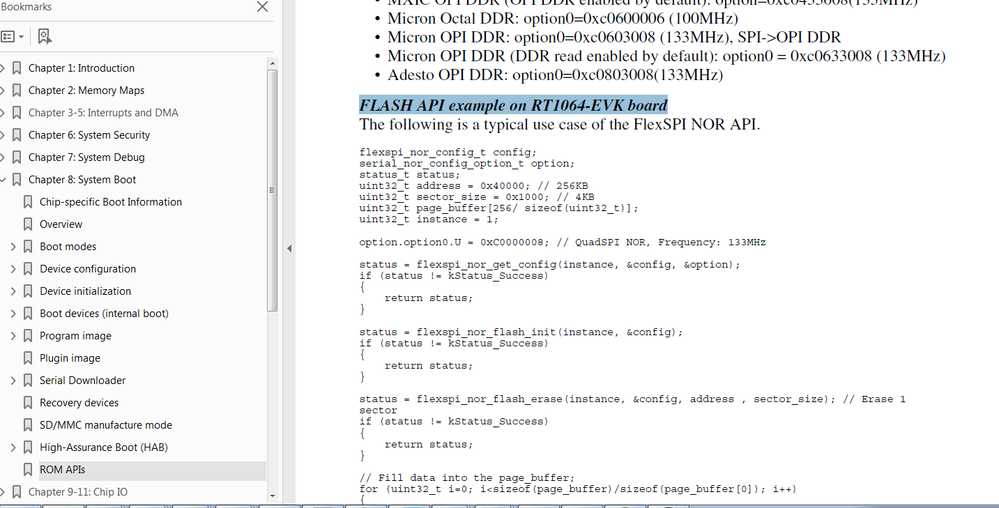

Specifically looking for information on programming the 4MB QSPI Internal Flash using the ROM API routines described in the RT1064 reference manual.

kerryzhou
Hi John Coppola,
    About the ROM API usage, you can refer to the RT1064 reference manual, there has a FLASH API examples on the RT1064-EVE board.
https://www.nxp.com/docs/en/reference-manual/IMXRT1064RM.pdf
Page 268
Wish it helps you!
