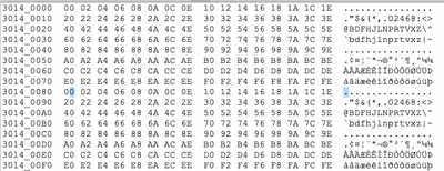

I am currently trying to read a page of test data from the external flash with the RT1176. I have written the following content to flash using the FlexSPI interface:

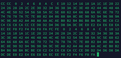

 I have validated that this data is written correctly and persists as expected. However, when I try to read this data using AHB I am getting invalid data where the first two bytes are always CC CC. This causes the data to be offset and results in the last two bytes of the stored flash data to be ignored (see below).
It appears that are the start of every page there is two bytes that contain CC CC despite there being no such data in the flash. I have made sure to clean and invalidate the D-Cache at the range I am reading from prior to performing a memcpy. I am using the following code to perform the read operation:
