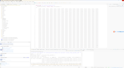

The project introduces  big array header files, but there is a stuttering and freezing state when saving and compiling. The chip is RT1170, and the compilation software is MCUXpresso IDE v11.9.1_2170

1. The 19MB data is in text size, and the actual binary file is 3MB. I allocated 3MB of space to the flash, which is sufficient.
2. When I copied and pasted the content of the generated conversion from a 3M binary file into the project's head file, I clicked on save for about 2 hours, which was too long. After the compilation was completed, about 1M of data was available, and the remaining part of the data was not available.
