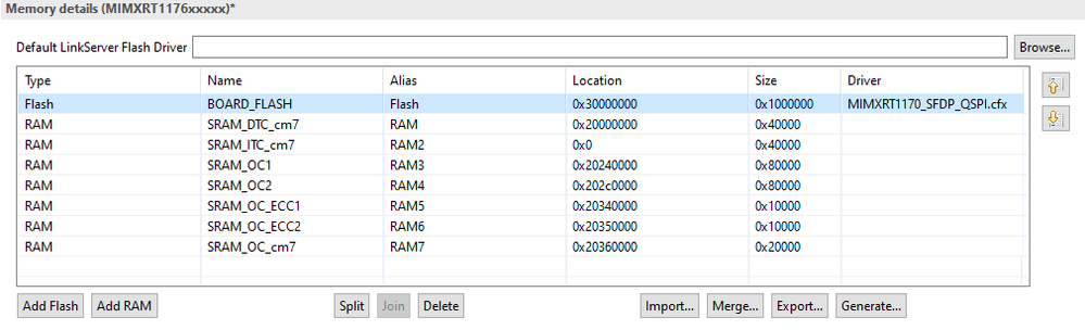

The memory layout was defined as in EVK:

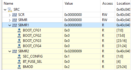

We can program and debug the microcontroller using Segger J-Link, however when booting or power cycling the device without debugger the application doesn't start executing.
We checked BMOD with debugger connected and it seems that BOOT_MODE is being latched correctly as 0x02 (Internal Boot).

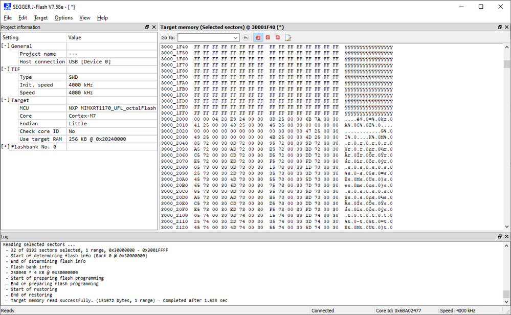

When dump read the flash memory to the PC using J-Flash, it appears that it's empty at address 0x3000000-0x30002000. I guess FCB block is missing and that's the reason application won't start.

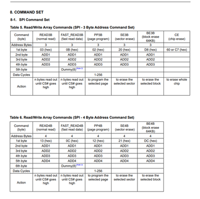

 If you want to use the SPI method, it is Single I/O. This mode, you need to use this list commander:
The  Octal flash should just support the Single IO and octal IO OPI method.
Yes, the data swapping is relevant only at OCTA mode.

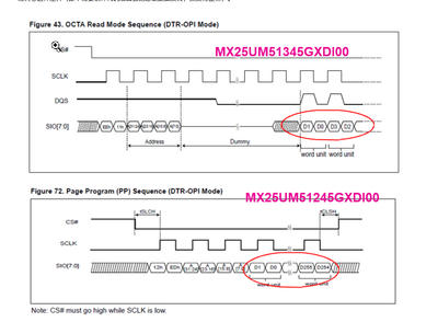

  In fact, I suggest you to use MX25UM51345GXDI00 instead of MX25UM51245GXDI00 , these two chips have the data swap difference:
You can see, the MX25UM51245GXDI00 data is:  D1、D0、D3、D2... sequence, it is not like MX25UM51345GXDI00, that's why you have the boot issues.

If must need to use MX25UM51245GXDI00, you need to do the flashloader dataswap, you can refer to this blog:
https://www.cnblogs.com/henjay724/p/15880374.html
As it is the Chinese document, but you can use the translation tool to read it, this is from the nxp internal expert, very useful to you.

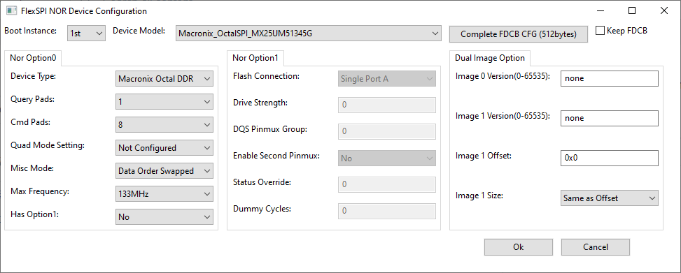

But, you still can use the blog method, you can try to use the MCUBootutility download with the data order swapped:
Whether this can boot OK or not?

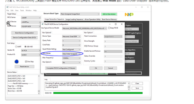

About the MCUbootutility is set like this blog:

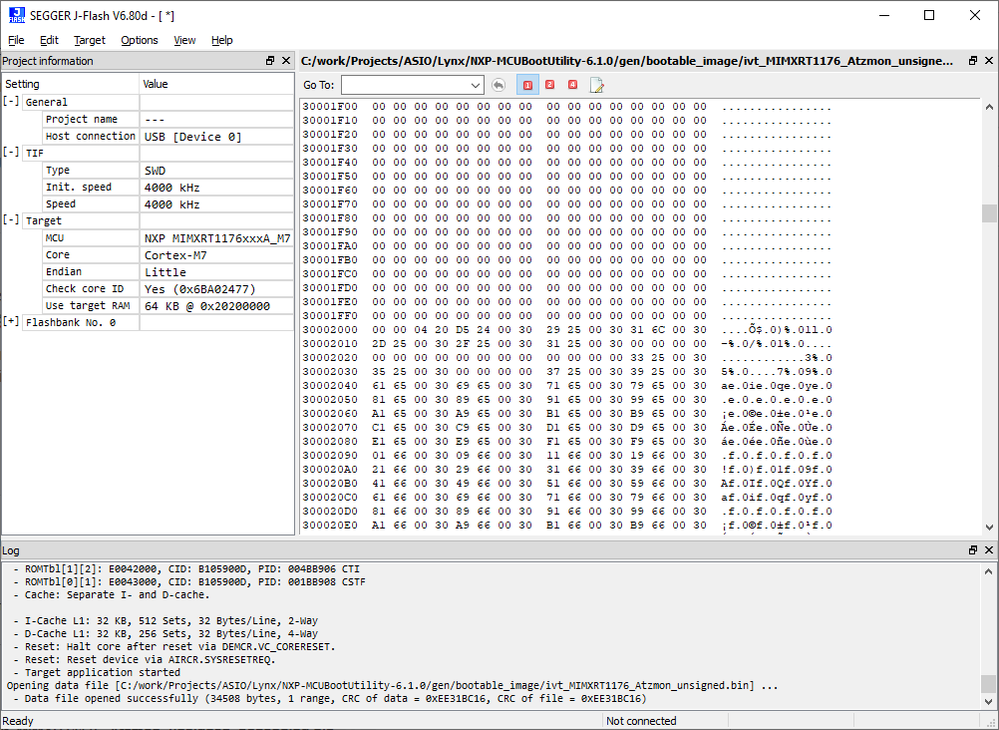

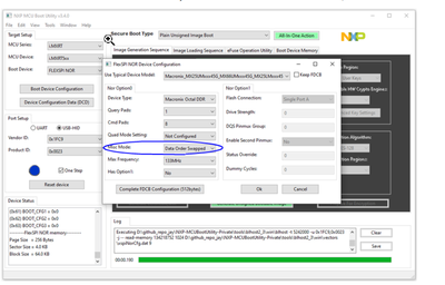

I tried to generate binary image using this settings:
Pressing "Generate Unsigned Bootable Image" generates two binary images, "_unsigned.bin" and "_unsigned_nopadding.bin" (attached them if something useful can be understood from them).
I've tried programming both of them with J-Flash, but none of them make the MCU boot up (I have a blinking RGB led application which works from debugger).
Please advise,
Ofir

Hi @ofirbo ,
  Can you use the USB or the UART to download the code in serial download mode directly? I mean, without the JLINK debugger.
  Your attached image is no FCB, as that method, the Tool will help you download the FCB directly.
  So, your image is lack the FCB now. Or another way, you need to modify your JLINK flashdriver, in the flashdriver, option to enable the swap function, then when you download the code, it will help you do the swap.

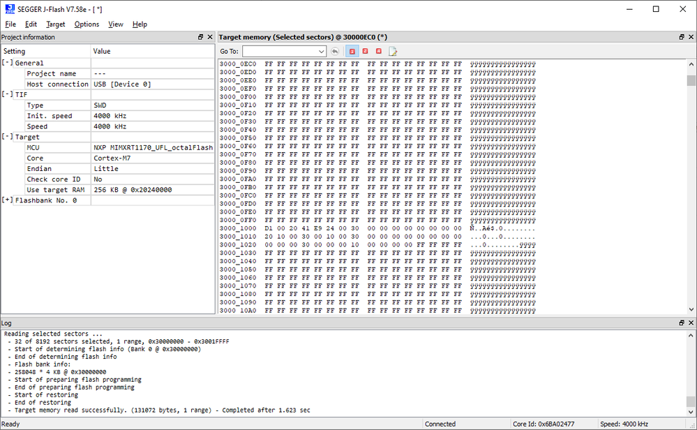

This is the read-back data after programming the chip via MCUXpresso and J-Link U-FL:
And last question - it seems that byte swapping is only relevant in DTR mode, what should I do in order to use normal (without byte swapping) 8READ command etc. so I can test the internal boot functionality.

Another thing that I see that that no matter what changes I make to the FDCB in source code with XIP_BOOT_HEADER_ENABLE=1, it's being overwritten in my flash memory to some default FDCB when running the J-Link debugger in mcuxpresso (checked it by reading it back from address 0x30000400)).
Is it being written by J-Link flash loader or by some internal function in the BootROM of the MCU? Why isn't it using the xip boot header specified in code?
Ofir

   Try the JLINK commander method, you generate the app with the FCB, then in the JLINK commander:
loadfile xxx.bin address
 After download, then you can use :
mem 0x30000000 end_address
to readout the memory, you can check the FCB again, it should your app image.
Normally, if you debug the code, your downloaded APP should your app FCB, not others.
Your situation seems modified by the JLINK flashloader.
