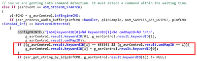

In my application I wanted to use the result.cmdMapID to save the code corresponding the detected command (fig2). The software works very well EXCEPT for one command, namely when the code is equal to 1.
In this case, I have the impression that the code in the function SLN_ASR_LOCAL_Process thinks it detects a wakeword. Note that I use Push-To-Talk mode and I do not use a wakeword.
I would like to know what the software in SLN_ASR_LOCAL_Process exactly does?
Is it only in case the code equals 1 that the value result.keywordID[1] is set to 65535 or do other values also trigger some actions?
Is there an option or a mode that would make this software works the same for all codes?

It is not a problem of the pronouncation of the command. I changed the cmdMapID of the different commands. The problem was situated in each command with the cmdMapID equal to 1.
In the test application, I tested first the index of the command in the commandlist which returns result.keywordID[1] and I only checked afterwards the cmdMapID.
But the index of the command returns not always in result.keywordID[1]. When the cmdMapID equals 1 then the index of the command returns in result.keywordID[0].
I added, as workaround the line indicated, and my test now works perfect.
However in my final application, I do not need to know the index of the command, it was only used for debugging purposes. I only need to know the cmdMapID. So, the problem is solved.

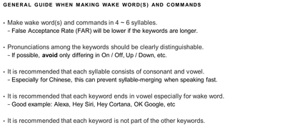

Some rule for the WC and VC
