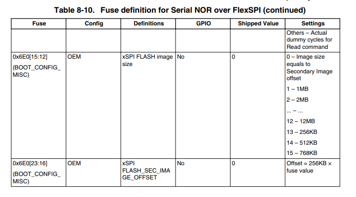

In the RT 1064 Reference Manual it is shown that the ROM API can be used to boot to selectable images which are programmed via in-application-programming.
What are the addresses of these image locations in internal flash memory? I can't seem to find any info on this and I need to know in order to do any kind of in application flash programming.
I need this for a bootloader. This application jump could be done in other ways but this seems like the most convenient one, am I misunderstanding something?

Please refer to the information as the below:
For FLEXSPI NOR, the first image address is always fixed, the 2nd image address is specified by the customer in EFUSE, only two images are supported on this device.
For NAND devices, the image 1, 2, 3 addresses are specified in the FCB.

mthimsen
Hi fangfang,
Thank you for your answer, would you happen to know which fuses specify this second address? I looked over the fusemap chapter of the 1064 RM but couldn't find any info on it.
2,602 Views
mthimsen
Nevermind I figured it out. Page 211 of the reference manual shows fuses for a secondary image size and offset.Capture.PNG

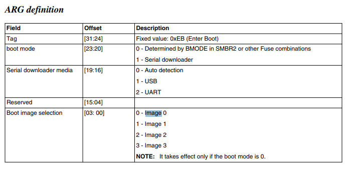

#:Depends on the upper table .uint32_t arg = 0xeb000001; It means the assignment for ARG. And select Image1 as the boot image after reliable update in user application. So assignment  [3:0] to related value depend on the selected Image. and not jump to the addresses.

fangfang
Depends on the ARG [3:0] after reliable update in user application. And ROM CODE will boot from the selectable image.

mthimsen
I understand that each image will have a different address, and that will depend on the value of ARG. What I am asking is where are the addresses of Image 0, Image 1, Image 2, and Image 3. People will need to know them in order to do any kind of in-application-programming in order to use this mechanic. There is no sense in booting to "Image 2" if you don't know how to put it there in the first place.
