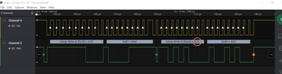

Problem:
When I was using I3C Interface, I found that I used RT685 as the Master to communicate with a Slave Device one-to-one, but in addition to the Address of the Slave Device, after testing, I found that RT685 will automatically respond to certain Addresses (currently in Master mode), how can I prevent RT685 from responding to these Addresses
Abnormal response Address:
0x0E、0x1A、0x34、0x35

3,222 Views
Andy_Sun
Hi @kerryzhou
My problem does not occur in the  ProcessDAA, let me re-describe my situation.
Currently there is an I3C Bus with only RT685(master) and a MCU(slave). This Slave Device has been configured with Dynamic Address (0x55) by SETDASA. When RT685 Emit a Transfer Write communication and the specified Address is 0x1A, at this time, the I3C Bus returns an ACK, and I am pretty sure that this ACK is not responded by MCU, because at this time MCU SDA IO is Input, so This means that RT685 responded to this Address on its own.
In this way, I found that these four addresses 0x0E 0x1A 0x34 0x35 will have the above-mentioned abnormal problems.
How can I avoid this problem?

kerryzhou
Hi @Andy_Sun
   So sorry for the later reply, I understand your question now.
   You want to know why the CCC SETDATA Slave Addr RT685 master send the ACK, just like the following picture:
With the correct slave address, the data is:
S+1101010 0 0
=S+6A+W+ACK
At first,  please check the mipi I3C spec
https://www.mipi.org/specifications/i3c-sensor-specification
After the slave address, it will contains the ACK bit.
So, I test the SETDASA CCC, my slave didn't have the related address, this is the test result:
You may say, 0X6A is ACK, but please don't just see the bus generated data, please check the bus wave,
In fact it is S+1101010 0 1
=S+0X6A+W+NACK
You can see, the response is correct, so no dynamic address send anymore.
