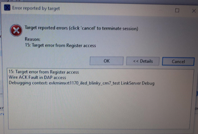

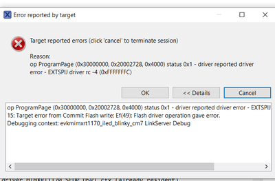

While programming via SWD in MCUXpresso the following error occurs

ancymuhammed
I had checked with the same EVK memory. But the below error is observed. By searching in net it is found that the below error normally occurs due to less current. VDD_3V3 is provided by 3A source & SNVS_3V3 by 150 mA.

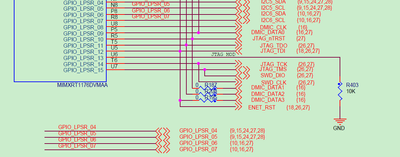

   Please also check the JTAG_MOD pin, it should connect to GND through 10k resistor:
