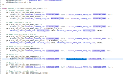

I am constructing LUT for W25Q128 QSPI Flash on my board. It is connected on FLEXSPI2 controller. I am trying to understand SDK example named "flexspi_nor_polling_transfer" on this purpose. I have several questions on that;

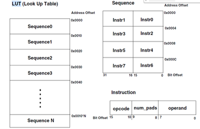

1- My first question, According to the reference manual IMXRT1170, one LUT is made up of 16 Sequences. Each sequence (total 16bytes) is made up of 8 instructions and each instruction is made up of 16bits (2 bytes). Here is the picture from ref manual;
Actually, "Sequence" means one entry in LUT. In other words, it is total action when sending any command to the connected Flash, such as all actions in one Read Status Register command or Erase Sector command.
ın SDK example, there is a constructor of  FLEXSPI_LUT_SEQ as follows;
#define FLEXSPI_LUT_SEQ(cmd0, pad0, op0, cmd1, pad1, op1) \
(FLEXSPI_LUT_OPERAND0(op0) | FLEXSPI_LUT_NUM_PADS0(pad0) | FLEXSPI_LUT_OPCODE0(cmd0) | FLEXSPI_LUT_OPERAND1(op1) | \
FLEXSPI_LUT_NUM_PADS1(pad1) | FLEXSPI_LUT_OPCODE1(cmd1))
So actually above define FLEXSPI_LUT_SEQ constructs 2 instructions with 4 bytes length. (produces uint32_t). Now in custom LUT[CUSTOM_LUT_LENGTH] array, there is an entry for "Page Program (Quad)" sequence as below;
/* Page Program - single mode */
#define NOR_CMD_LUT_SEQ_IDX_PAGEPROGRAM_SINGLE    4
[4 * NOR_CMD_LUT_SEQ_IDX_PAGEPROGRAM_SINGLE] =
FLEXSPI_LUT_SEQ(kFLEXSPI_Command_SDR, kFLEXSPI_1PAD, 0x02, kFLEXSPI_Command_RADDR_SDR, kFLEXSPI_1PAD, 0x18),
[4 * NOR_CMD_LUT_SEQ_IDX_PAGEPROGRAM_SINGLE + 1] =
FLEXSPI_LUT_SEQ(kFLEXSPI_Command_WRITE_SDR, kFLEXSPI_1PAD, 0x04, kFLEXSPI_Command_STOP, kFLEXSPI_1PAD, 0),
Actually, I am totally confused on above. Why we seperate single pageprogram sequence LUT Entry as 2 different entries? I mean in "one sequence", I can construct 8 instructions with each of 2 bytes. Then why we add one more extra entry as [4 * NOR_CMD_LUT_SEQ_IDX_PAGEPROGRAM_SINGLE + 1] ? Is not it possible to define above as below;
So I can use entry 5 for the other sequence such as
#define NOR_CMD_LUT_SEQ_IDX_ERASECHIP 5
[4 * NOR_CMD_LUT_SEQ_IDX_ERASECHIP ] = ....

3- My last question is; Ref manual says that,
So in example SDK, I see that some LUT entries has not STOP command.
In above, STOP command was put there only if the define of
FLEXSPI_LUT_SEQ(kFLEXSPI_Command_SDR, kFLEXSPI_1PAD, 0x06, kFLEXSPI_Command_STOP, kFLEXSPI_1PAD, 0) has only one instruction.
However, such as in below entry, it has 2 instructions. But it has no kFLEXSPI_Command_STOP as in the above.
[4 * NOR_CMD_LUT_SEQ_IDX_WRITESTATUSREG] =
FLEXSPI_LUT_SEQ(kFLEXSPI_Command_SDR, kFLEXSPI_1PAD, 0x01, kFLEXSPI_Command_WRITE_SDR, kFLEXSPI_1PAD, 0x04),
Actually what I am trying to explain s that in one entry (Sequence) Can I write
FLEXSPI_LUT_SEQ(..., ..., ..., ..., ..., ...),  // 2instruction
If correct, then all LUT entries have missing STOP command.

1.Each instruction is made up of 16bits (2 bytes).
#define FLEXSPI_LUT_SEQ(cmd0, pad0, op0, cmd1, pad1, op1) (FLEXSPI_LUT_OPERAND0(op0) | FLEXSPI_LUT_NUM_PADS0(pad0) | FLEXSPI_LUT_OPCODE0(cmd0) | FLEXSPI_LUT_OPERAND1(op1) | FLEXSPI_LUT_NUM_PADS1(pad1) | FLEXSPI_LUT_OPCODE1(cmd1))
So One FLEXSPI_LUT_SEQ includes two instructions(32 bits).
And const uint32_t customLUT[CUSTOM_LUT_LENGTH] = {
The type of array elements is uint32_t, [4 * NOR_CMD_LUT_SEQ_IDX_PAGEPROGRAM_SINGLE] represents the 16th element of the array. This element can be up to 32 bits, so it can only contain two instructions.
and [4 * NOR_CMD_LUT_SEQ_IDX_PAGEPROGRAM_SINGLE +1 ] represents the 17th element of the array.

3.[4 * NOR_CMD_LUT_SEQ_IDX_WRITESTATUSREG] =
You can't do that, for the reason I explained in the first item.
Hope this will help you.
Hang

Regarding question three: Filling the instructions with zeros is an implicit stop-command.

Thank you @Masmiseim . I reviewed your supplied link. That is what I am thinking that it must be for a single sequence in LUT Table. Actually, after looking your code with filling 0 means implicit STOP command, I realized that in SDK example, it is correct;
[4 * NOR_CMD_LUT_SEQ_IDX_READ_NORMAL] = ....
[4 * NOR_CMD_LUT_SEQ_IDX_READ_NORMAL + 1] = ...
The above lines 2 entities of one single sequence. The other 2
[4 * NOR_CMD_LUT_SEQ_IDX_READ_NORMAL + 2] = ... and [4 * NOR_CMD_LUT_SEQ_IDX_READ_NORMAL + 3] = ...  is also set with "0" while initializing.
So there must be total 4 x sizeof(uint32_t) gaps between each sequence. So example satisfies it.
