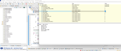

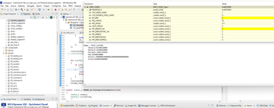

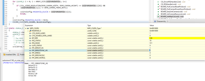

I have imxrt1166 eval board and have ovp5640 camera. When I changed  "tHsSettle_EscClk" parameter in examples of SDK to a higher value, I am getting the one bit error, two bit error and other ones respectively from MIPICSI2RX peripheral with debugger. See the screeenshots below.

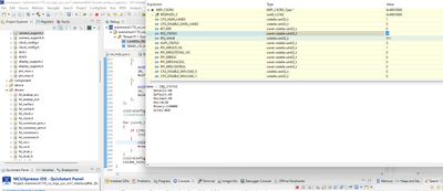

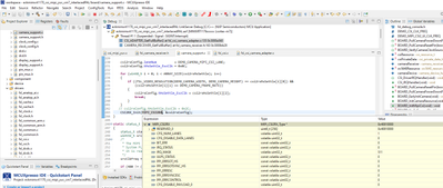

However, when I changed the same parameter value to a higher value in my custom PCB, I do not get any one bit and two bit errors. See the screenshots below;
If I set this parameter to the value what it must be, then I got no error from both eval board and my custom PCB. In my custom PCB, I am setting that parameter to 0x0C. In eval board, I remains it unchanged as in sdk example.
I am trying to find the problem I faced for some time regarding ADV7280-m decoder chip. I could not get video from adv7280-m yet. That is why I am changing it deliberately to see the difference between eval board and my board. Waiting your assistance.
