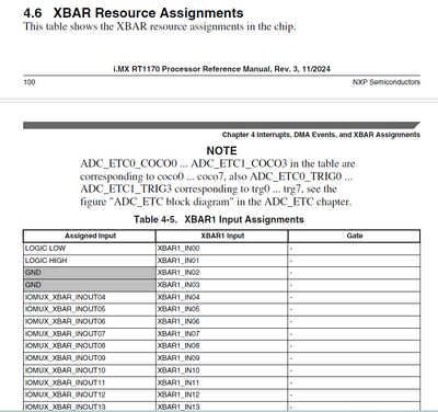

Hi, is there a way to connect WDOG_B to another pin with XBAR functionnality ?
I ask this because manual isn't clear to understand, I think that is not possible because I checked if the pin exists in the section XBARA1 (ConfigTool->pin->peripherical signal MCUXPRESSO).

Hi @Nexus76 ,
Question: is there a way to connect WDOG_B to another pin with XBAR functionnality ?
Answer:
I check RT1170RM reference manual, the inputs of XBAR are list in the left of the following Fig.
There are no WDOG relevant inputs selection.
You can also find the detail description in chapter 4.6 XBAR Resource Assignments.
Wish it helps you.
