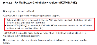

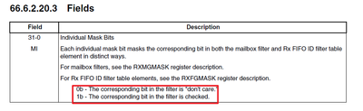

Hi @Seunghyup ,
RXMGMASK: RXMGMASK is used to mask the filter fields of all Rx MBs, excluding MBs 14-15,
which have individual mask registers.
Please pay attention MCR[IRMQ] setting.
RXIMR0~63: These can allow  more fine-grained filtering settings for each available Rx mailbox.
Wish it helps you.

Seunghyup
Testing Based on Your Response:
MB0: RX 0x64
MB1: TX
MB2: RX 0x67
RXMGMASK = 0x1FF3FFFF
When testing with this configuration, I confirmed that MB0 could receive IDs ranging from 0x64 to 0x67 in its buffer.
I understood that the setting for the RXMGMASK is based on configuring '0' bits for the range between criterion A and criterion B, which defines the allowed IDs.
