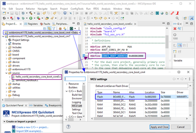

mayliu1
Hi @radoslawp ,
Thanks for your reply.
I understand your needs, you want CM7 core as master, CM4 core as slave, both CM7 and CM4 are XIP .
Please refer  SDK demo as following.
\SDK_2_16_000_MIMXRT1170-EVKB\boards\evkmimxrt1170\demo_apps\hello_world_secondary_core_boot\cm7
\SDK_2_16_000_MIMXRT1170-EVKB\boards\evkmimxrt1170\demo_apps\hello_world_secondary_core_boot\cm4
The following image is shared by RT expert Jay on his blog.
Wish it helps you.
