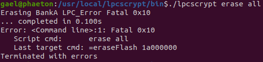

To erase and program the flash I switch to LPC-Link2 Segger J-Link firmware following the instruction of AN13206.
Then I follow the instructions to switch back to default firmware OpenSDA DapLink firmware. The following error occurs when executing the "./lpcscrypt erase all" command, but I wasn't worried since it is specify that "Errors may be reported but can be ignored.".
Following steps don't report errors and at the end my computer recognize the mass storage device with the name RT1064-EVK.
Then I deal again with the problems described above.
