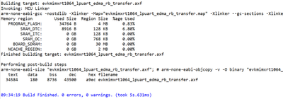

It seems a bit weird, the attachment is the lpuart_edma_rb_transfer demo that I imported it from the SDK 2.11.0 to the MCUXpresso IDE (v11.5.0), it doesn't have the compile error as you mentioned before actually.
TIC

I think your code has no overflow factors. I have big data structures related to my project. I put my Heap and Stack to OCRAM and activate optimization level 2 it is now working. But there is a problem when I tried to put them on BOARD_SDRAM. I am not able to move on code it is stopping even no break point is exist. Sometimes, it is also halting. I hope can be solved it.
Thanks and Regards.
