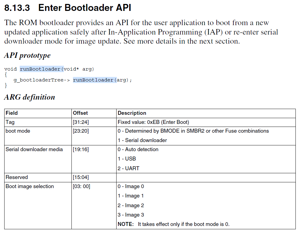

Hello all,
I am trying to update firmware using ISP mode on IMXRT1064 using boot ROM. I want to know, Is there a software/programmatic method to enable ISP at System Reset without using switches?  So many people asking for this solution. Please provide document or working example for this.
标签 (1)
标记 (1)
1 回复
1,146 次查看
jeremyzhou
Hi Sagar Prajapati,
for the opportunity to serve you.
In the RT1064, the ROM APIs provide an API to re-enter serial downloader mode for image update, I think it can implement your application.
