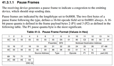

For example below figure showing some details for Pause Frame. I could not find frame details for Native Ethernet PTPv2 in RM section 41.3.3.1.2. Where can I find a reference for sending multicast frame like below figure?
Thanks and Regards.

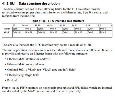

  • By the way, I found some details for Ethernet Frame in RM section 41.3.15.1 and Table 41-36. It validates out expectations. It says frame payload from starts from 14 and ends with N. But issue is still chaotic. There is no exact definition what holds for last 30 bytes. Why it doesn't permit to assign data apart from 0x00 and rising hard fault.
I hope you safe and healthy.
