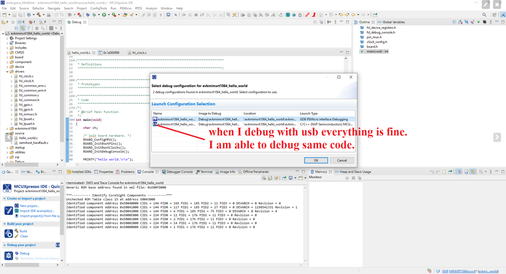

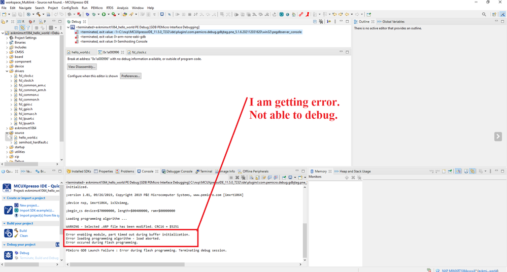

I am getting below error during debug with P&E Micro Probe. Could you please inform me about the possible errors and tricks for debug with P&E Micro Debug probe with MCUXpresso? I tried to erase the flash, before debug but nothing is changed.
I am not getting error when I debug with USB:

Hello, sorry I do not understand, in the first image looks like not found the main(), and the second only show the probes available but is not doing anything like debugging.
I understand the following you have the RT1064, but you don't what to use the debugger on the board and have a P&E Micro Multilink.

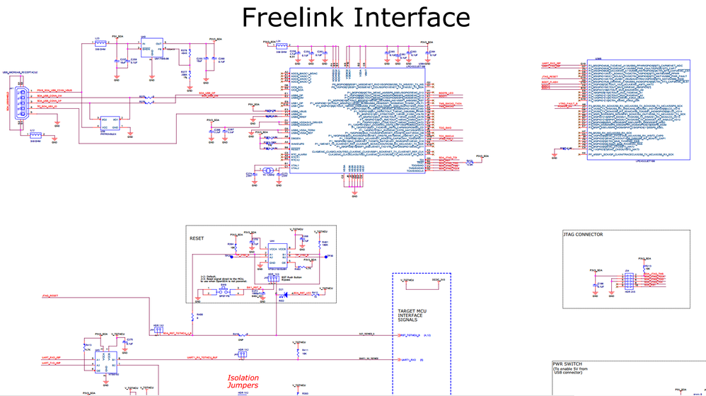

Did I understand correctly,  Will I am not be able to debug with J34 even I use LPC-Link2 probe? I am a bit confused because the Reference Manual says below and I thought that I will be able to debug my card with J34 if I use FreeLink Interface's JTAG connector. Does this FreeLink JTAG Connector(J34) supports debugging?
First Clue:
Second Clue:
Is the only way of debugging my card "using J21" with debug probe like PEMicro, MCU Link or Segger Probes?
No, the other way to debug is using the microUSB J41, but if you want to use the external debugger Multilink the only way to debug is the J21.

Q1: I asked my question for not only EVK. For example, we plan to design a specific card by using RT1064 in our university research lab. Is the J34 not valid for debugging with LPC-Link2 ?
Q2: Why reference manual says J34 is compatible with LPC-Link2 probe?
Q3: Where can I learn functionality and proper usage information of each connector or pin in MIMXRT1064-EVK? I am asking this because I thought that J34 compatible with LPC-Link2 probe when I look RM and SPF-32221_A2.pdf schema file. If I had a descriptive document I couldn’t make design on it. Could you please inform me about if such kind of document exist which is descriptive for each connectors usage purpose ?

Q1/ Unfortunately no, the J34 is only for updating the firmware in the debugger on the board, if you want to debug your code in the RT1064 with the LPCLink2 you need to use like image. The red section in the image is the debugger built into the board.
Q2/ I can confirm that information in the Reference Manual IMXRT1064RM Rev. 2, 07/2021. The LPC Link2 is still compatible with the RT1064, which is an older debugger the new versions are the MCU link and MCU link Pro, even in the page says the next. LPC-Link2 | NXP Semiconductors Not Recommended for Designs, but if you still have one you can update the firmware in the debug probe of your board.

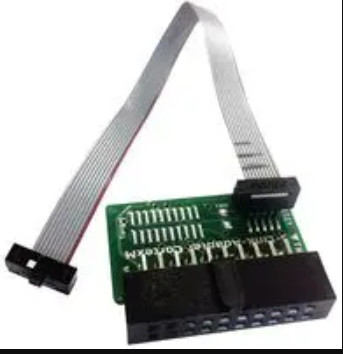

I recommend using this adapter for the SWD to JTAG.
I attached the document of the board maybe could help you 2.12. JTAG connector.
