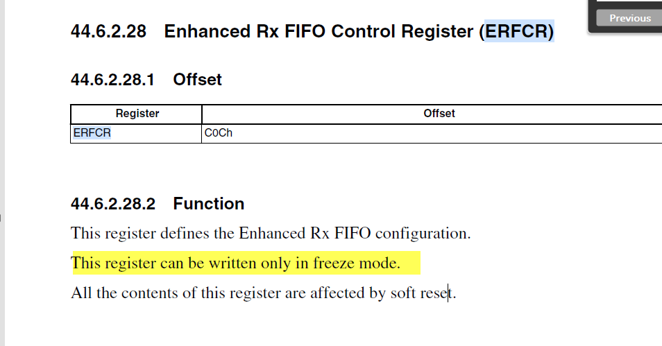

According to the 1060RM setting the ERFCR will enable the Enhanced FIFO.  However when I try to even read the register in the FLEXCAN  example it throws a hard fault.  When I tried it in my own application on a imxrt1062 I also get a hard fault at that register address.  Needless to say I can't set it either.
So the question is, what is the cause of the issue and is Enhanced FIFO even enabled and the RM is incorrect?

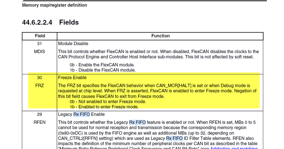

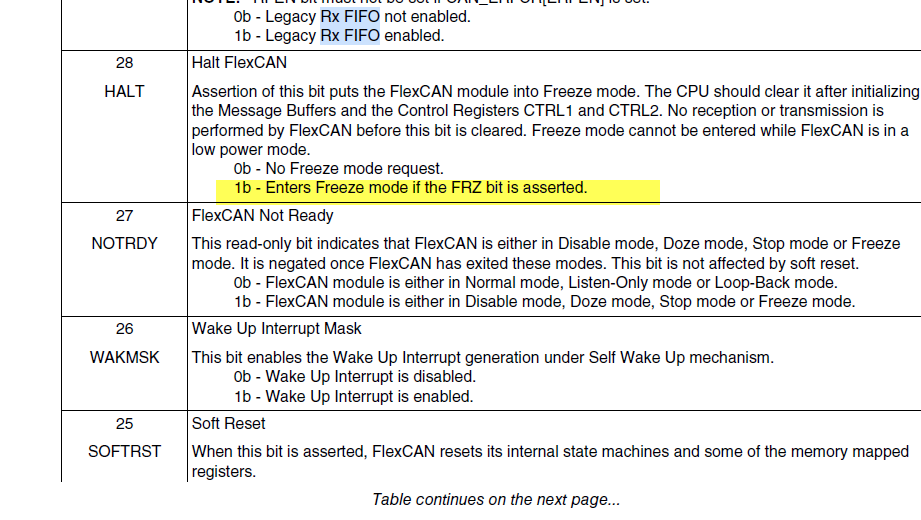

  If just add your code, it really has problems when read the 0x401d8c0c, it is the ERFCR register.
Please note, when the module in freeze mode, this register is written only, it means you can't read it.
From your reply, I find your 0x401d8000 = 0x5980000f.
Please check these register:
Your bit 28, and 30 is 1, it means your flexcan module is in freeze mode, that's why you read the ERFCR have hardfault.
Please disable the freeze mode, then try to read ERFCR register again.

Kerry Zhou wrote:
> > The register can only be written in Freeze Mode.
That is not what that sentence says. In English that means:
Mode    | Read Access | Write Access |
Freeze  | Yes         | Yes          |
Normal  | Yes         | No           |
It is normal for some registers to be written only in "Freeze Mode". The Register Diagrams for all registers clearly show them all as "Read/Write". There's no "Write-Only" indications anywhere. There's nothing in the manual that says these registers can only be read in "some modes" or with "some settings".
Note that NONE of the "Extended" registers can be read. This includes ERFSR at 0x401d8c14. That is a STATUS register, which has to be read to be useful. It doesn't have the "written in freeze mode" note in its description.
Did you test that? Did you set the CAN module into "Run Mode" and prove the registers can then be read? I've tested it and it doesn't work:
# Force a Soft Reset
(gdb) set *0x401d8000 = 0x2000000
# Verify MCR is now in its reset state
0x401d8000: 0x5980000f
# Turn Freeze mode off and verify it is off
(gdb) set *0x401d8000 = 0x0080000f
(gdb) x 0x401d8000
0x401d8000: 0x0080000f
# Try to read ERFCR and ERFSR
(gdb) x 0x401d8c0c
0x401d8c0c: Cannot access memory at address 0x401d8c0c
(gdb) x 0x401d8c14
0x401d8c14: Cannot access memory at address 0x401d8c14
Maybe it needs a more complicated and complete setup to be able to access those registers. Please provide working code that demonstrates the FlexCAN setup that allows register access, if that is possible.

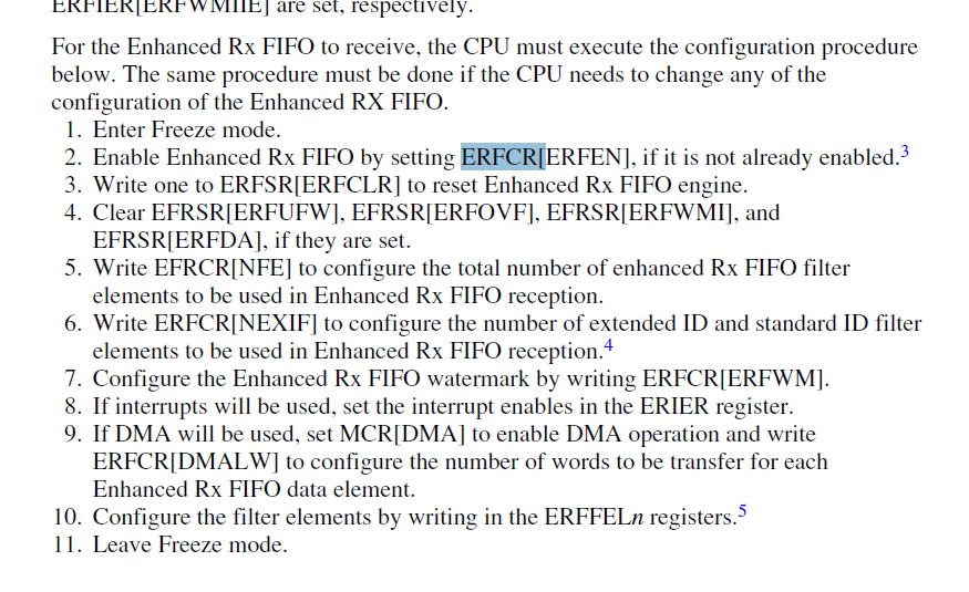

(Edit): The following says the device has to be in "Freeze Mode" to change these registers. The only requirement mentioned for the following to work is "(3) MCR[RFEN] must be cleared so that Enhanced Rx FIFO is enabled.". That bit was cleared in my tests.
44.4.7 Enhanced Rx FIFO
For the Enhanced Rx FIFO to receive, the CPU must execute the
configuration procedure below. The same procedure must be done
if the CPU needs to change any of the configuration of the Enhanced
RX FIFO.
1. Enter Freeze mode.
2. Enable Enhanced Rx FIFO by setting ERFCR[ERFEN], if it is not
   already enabled. 3
3. Write one to ERFSR[ERFCLR] to reset Enhanced Rx FIFO engine.
4. Clear EFRSR[ERFUFW], EFRSR[ERFOVF], EFRSR[ERFWMI], and
   EFRSR[ERFDA], if they are set.
5. Write EFRCR[NFE] to configure...
etc.‍‍‍‍‍‍‍‍‍‍‍‍‍‍

kerryzhou
Hi Michael Smorto,
   Do you follow this procedure?
Kerry

For the easy answers.  Yes I did follow the procedure the procedure that you reference from the manual including entering freeze mode before making the changes.
As for your question "Are you sure "CAN_MCR[RFEN]" isn't set?"  - will have to do a double and check and let you know about that one as well as your other questions in your first post.  In regards to the clocks being set, that I can say yes they are set for sure.
Mike

In the app after setting the clocks (know this works - the sdk example works on my hardware).  I do a call to:
    FLEXCAN_FDInit(EXAMPLE_CAN, &flexcanConfig, EXAMPLE_CAN_CLK_FREQ, BYTES_IN_MB, true);
After that I do a call to my function:
    FLEXCAN_SetRxEnhancedFifoConfig(EXAMPLE_CAN, true);
With that function looking like:
void FLEXCAN_SetRxEnhancedFifoConfig(CAN_Type *base, bool enable)
    Serial.println("Entered FIFO Config");
 //only valid for Flexcan3..........
    /* Assertion. */
    //assert((config) || (false == enable));
    /* Enter Freeze Mode. */
    FLEXCAN_EnterFreezeMode(base);
 Serial.println("Entered Freeze Mode");
    if (enable)
    Serial.println(CAN_ERFCR_ERFEN(1), BIN);
    delay(5000);
     Serial.println(base->ERFCR,BIN);
    delay(5000);
  base->ERFCR |= CAN_ERFCR_ERFEN(1);  //Enable enhanced FIFO  <======= Dies here......
    delay(5000);
  FLEXCAN3_ERFSR = CAN_ERFSR_ERFCLR(1);  //Reset RxFIFO engine
  //Clear EFRSR bits
  FLEXCAN3_ERFSR = CAN_ERFSR_ERFUFW(0) | CAN_ERFSR_ERFOVF(0) | CAN_ERFSR_ERFWMI(0) | CAN_ERFSR_ERFDA(0);
  FLEXCAN3_ERFCR |= CAN_ERFCR_NFE(2);   //Configure total number of Rx FIFO filter elements
  FLEXCAN3_ERFCR |= CAN_ERFCR_NEXIF(3);  // number of extended ID & standard ID filter elements
  FLEXCAN3_ERFCR |= CAN_ERFSR_ERFWMI(1);  // number of messages in FIFO greater than the watermark
  FLEXCAN3_ERFIER = 0x01;      // Enable interrupts if they are to be used
  //  TBD         // Enable DMA operation in MCR[DMA]
  //FLEXCAN3_ERFCR |= CAN_ERFCR_DMALW(1);  // to configure number of words to be transfered for each data element
  //Configure filter elements by writing to the ERFFELn registers?
  //FLEXCAN3_ERFFEL0...127
