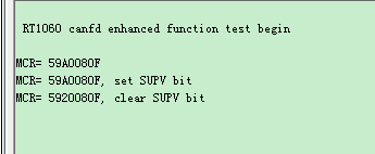

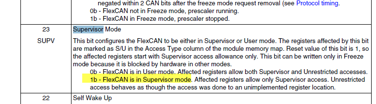

kerryzhou
Hi Tom Evans and Michael Smorto,
    Thanks a lot for both of your effort and time.
     In factor, I also tested the other enhanced function on my side, I have reproduced the problem, BTE can't be set, EPRS, ENCBT, EDCBT and ETDC will also enter hardfault. So, I already send my test result and code to our related department, and report the problem, if it is confirmed the bug, they will help to update both the document and the SDK header file in the future.
    If I get the confirmation feedback, I will let you know ASAP.
    Thanks again for the contribution.
    About the supervisor mode, from the RM, it can be set in CAN_MCR[SUPV]
I write this code to test it:
    PRINTF("\nMCR= %X",  EXAMPLE_CAN->MCR );
    EXAMPLE_CAN->MCR |= (1<<23); // BTE
    PRINTF("\nMCR= %X, set SUPV bit",  EXAMPLE_CAN->MCR );
    EXAMPLE_CAN->MCR &= ~(1<<23); // BTE
    PRINTF("\nMCR= %X, clear SUPV bit",  EXAMPLE_CAN->MCR );
You can find it can be set to supervisor mode or the user mode.
Wish it helps you!
Kerry

TomE
Specialist II
That didn't answer his question.
Your answer says how to change how the CAN module responds to the different CPU User/Supervisor accesses. Michael asked how to write code to make the CHIP (the CPU core) generate those different cycles.
This isn't in the RM because there are almost no details about the CPU core in there. There are only three pages on the core in Chapter 27. It would help if that section said where to look for the documentation, but it doesn't.
Section "1.1.3.1 General Information" says:
For information about the ARM Cortex processor see:
* http://infocenter.arm.com
NXP and everyone else gets their cores from ARM because that means they don't have to design, test, document or write compilers for their own (usually custom) cores any more. This also keeps them on the leading edge of performance, features and power.That's why there haven't been any new ColdFire-based chips lately.
The ARM web site is very complicated and it is difficult to get the details for the specific core that is in the chip you're interested in. There are a huge number of different cores, and also lots of different options for each core that a manufacturer can select. Then there's a lot of optional extras and peripherals, like memory or bus interfaces that might or might not be present. Google finds this to (start to) answer Michael's question:
Assembler User Guide: Processor modes, and privileged and unprivileged software execution
Tom
