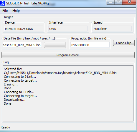

camillelouapre
Hello jeremyzhou,
I am using JLink tools V6.52b, an I am on Linux Mint.
Here are described steps for flash programming the release binary:
  • Open JFlashLiteExe (GUI)
  • Select device MIMXRT1062XXX6A
  • Select SWD, 4000kHz
  • Erase chip
  • Set prog address 0x60000000
  • Select binary browsing folders
  • Click "Program device"
  • Reset EVK with SW9 button
You will find attached built binaries/map files for debug/release.
Maybe an hardware/jumper/switch setting ? I did not find any clear information about jumpers (except hardware design).
Thanks for your help,
Camille

jeremyzhou
Hi Camille Louapre,
Thanks for your reply.
I've programmed the release version of PCK_BRD_MINUS.bin to the MIMXRT1060 as the Fig 1 shows, it seems to program successfully, however it doesn't work actually.
I also try to program the release version of hello_world.bin which is the demo project from the SDK library, it can work well.
Fig 1
So I think the issue is not related to the hardware.
Comparing the size of debug and release version of the PCK_BRD_MINUS.bin, the release version is almost 6 KB smaller versus the debug version, it seems a bit weird, for the SDK library's demo project, they are almost as big as each other.
So I'd like to suggest you check it.
TIC
