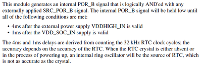

I am driving DCDC_PSWITCH HIGH to turn on the DCDC converter but I do not see any documentation beyond that. What happens if I drive DCDC_PSWITCH low after it has been HIGH? Can I use this to shutdown the cpu if the voltage drops below a certain voltage and start it back up when it is stable again? Is this safe?
I have experimented with driving it LOW and it seems to reset the processor back to the state when it is waiting for DCDC_PSWITCH to go HIGH. I am then able to drive it HIGH to start everything back up. I am just wondering if this is intended behavior and what exactly is happening when I do this?

Thanks for some clarification on the topic. One detail I failed to provide is that my current plan is to leave POR_B disconnected and allow the internal POR_B to take over. In this case can I toggle DCDC_PSWITCH without issues and allow the internal POR_B to toggle itself accordingly?
In my testing everything seems to work just fine, I'm essentially able to use DCDC_PSWITCH as a reset (Without needing an external POR_B), but I am doing so without knowing how the internal POR_B is behaving. My guess was that once DCDC_PSWITCH goes LOW, internal POR_B no longer meets the requirement of VDD_SOC_IN being high and goes low. Then it will wait for the requirement to be met again which it should after DCDC_PSWITCH goes HIGH again. This is just a theory as I am unable to verify this with any documentation or access to internal POR_B.

If you leave POR_B disconnected or pulled high the internal POR signal will take over (AND'ed).
According to the description it will follow the VCC_SOC_IN supply and delay negation by 1ms, which means that you can probably do what you are doing and use the DCDC_PSWITCH input to control the power and also reset.
This is however something that I haven't done and so have no practical experience on its overall reliability. My technique has always to be in control of the details and also the overall power supply cycling so that recovery from any latch-up situations (particularly related with initial silicon), ISP and debugger control can be ensured.

The DCDC_PSWITCH input enables/disables the internal DC/DC converter that generates the 1.1V for the VDD_SOC_IN and it is advised to also set the processor's reset input (POR) to '0' when this is not ready - thus, if powering down this voltage by using the DCDC_PSWITCH, it is also advised to hold the processor in reset (POR) while it is powered down and until it has powered up again - meaning that POR should stay low for about 10ms after DCDC_PSWITCH has been taken high (again) to ensure it has stabilised.
For users of A revision silicon (although I believe it is only critical for 105x parts), more attention has to be paid to power cycling due to a few HW erratas that can stop the DCDC converter starting and inrush current on GPIOs when the 1.1V is not available that can - in the worst case - damage the device.
This is the timing for 105x parts with errata workaround as reference, whereby the complete sequence should be repeated when powering down the internal DCDC converter.
