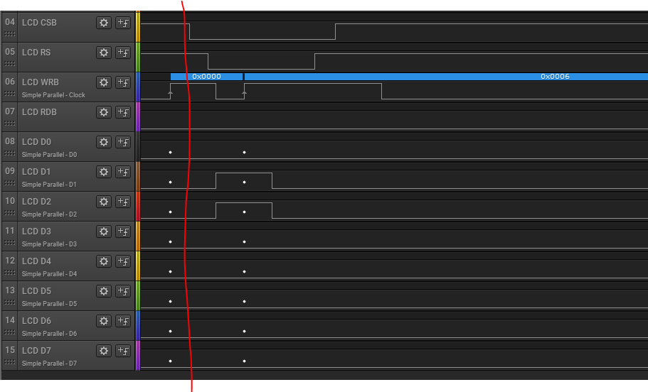

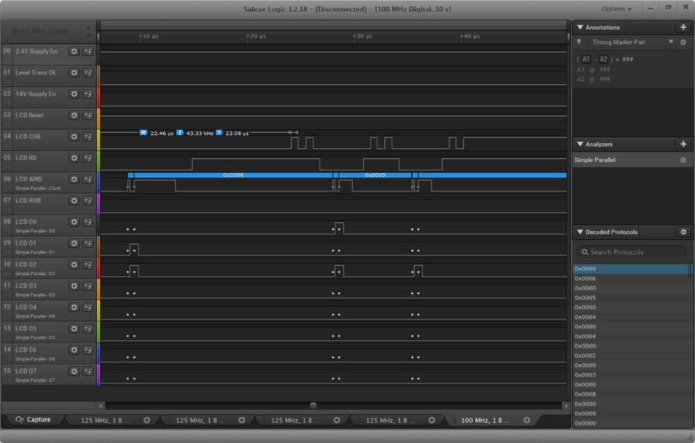

I'm trying to get an 8080 MCU LCD working on the FlexIO interface on an IMXRT1050. It looks like data is clocking out correctly for the most part however I'm having trouble with the WR and RD pins. They are resting low, then rising just before clocking out data. So I'm getting extra zeros in my data stream. Any ideas?

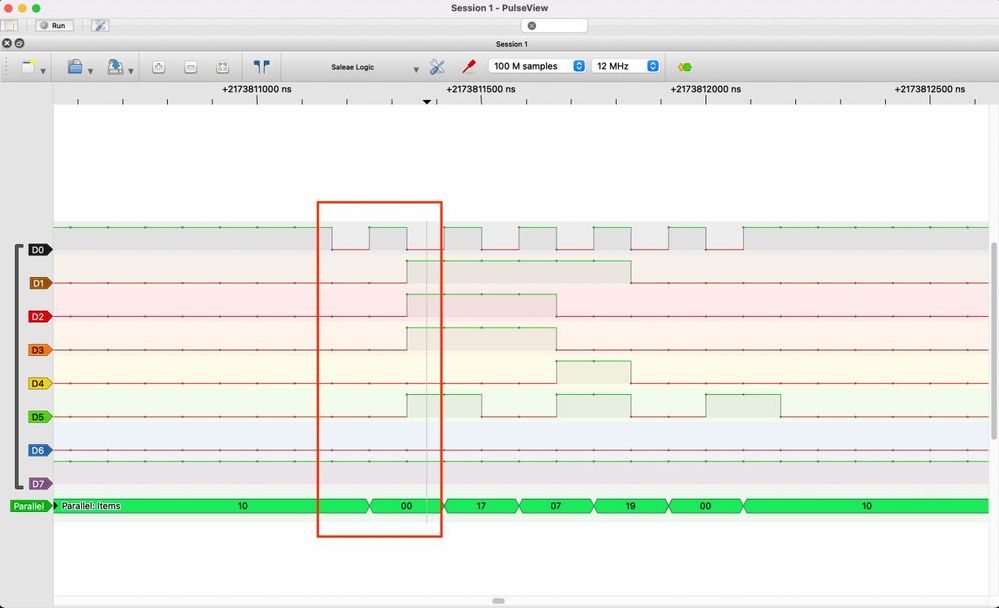

Although I am not using the official NXP demo code, I have based the configuration of the FlexIO module, shifter and timer in an identical manner to the HX8357 NXP example for the KL28/RT1050 (AN5313/AN12822), and I am also getting an early pulse on the WR as soon as the shifter is loaded on a single beat transmit
My code looks like so:

I then call this function from my main loop ever 500ms by calling singleBeatWrite and passing the data
uint8_t bufferData[4] = {0x17, 0x07, 0x19, 0x90};
singleBeatWrite(bufferData,4);

So what is causing my issue is that the value on my RW pin is changing when FLEXIO_MCULCD_SetSingleBeatWriteConfig(base) is called and then dropping again when FLEXIO_MCULCD_ClearSingleBeatWriteConfig(base) is called.
One option I've tried is to refactor FLEXIO_MCULCD_WriteCommandBlocking to set the config first, the pin rises, then call FLEXIO_MCULCD_StartTransfer(base) so my CS pin gets set. Then do the opposite at the end of the function. This way my lcd driver should ignore those extra transitions on the WR line.
I would also need to do similar refactoring for the other read/write functions.
Although I should mention that I am measuring these signals straight out of the MCU and one of my coworkers mentioned that the LCD Driver may hold these lines up anyway and this whole issue will be moot.
