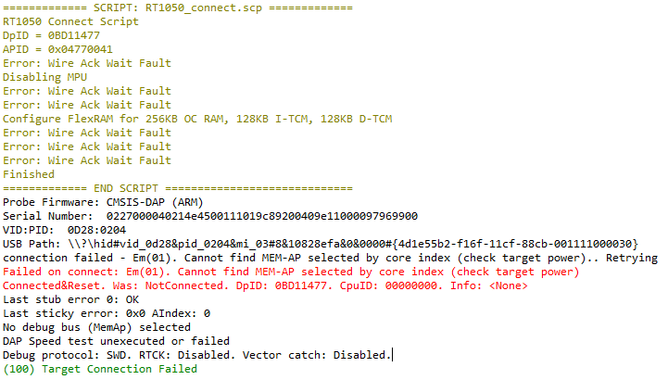

I am relatively new to NXP and I've been playing a bit with IMXRT1050-EVKB (REVA1) for some time now. I suddenly started to have problems with CMSIS-DAP debugging capabilities. Basically I get the following messages:
I can recover from this state switching back and forth boot modes on SW7  but the issue will be reproduced again and again, making the development process very painful and slow.

My bootloader version is 0244, really higher than you.
So, please go to this link, and updated your CMSIS DAP version:
https://www.nxp.com/design/microcontrollers-developer-resources/ides-for-kinetis-mcus/opensda-serial...
Board enter bootloader mode, and download the newest DAPLink v0244 - Supports onboard hyper-flash, then exit the bootloader mode, can you make it works?
BTW, do you try the official SDK project, whether you also have the CMSIS debugger issues or not?
As I know, if the app code have issues, it will also cause the debugger connection issues, then you need enter the serial downloader mode, and erase the external flash at first.
Wish it helps you!
Kerry

To answer your question, no, the issue doesn't happen when I can successfully recover from that state an run an SDK example, it happens always while running the code I am playing with, and exactly at the same code point. I just didn't expect an app issue will mess with the debugger connection.

Answer: Please help to check, whether this debugger issue just in your own project, SDK project no issues, right?
In fact, just as I have said, when the project have the running issues, it may cause the chip boot failed from the external flash, the chip will take the external flash code as invalid, then it will cause the debugger issues, that's why you erase the external memory, and it works again, this is the know issue to the debugger, the workaround is to erase the external flash memory.
