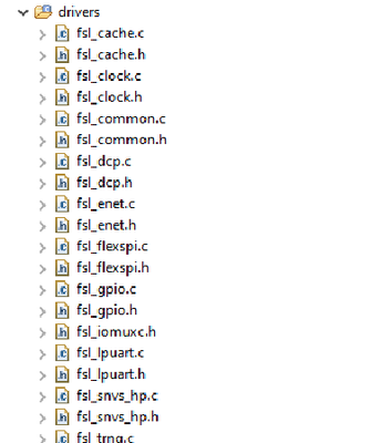

If you need SNVS_HP driver, I would suggest  you add the driver manually. fsl_snvs_hp.c and fsl_snvs_hp.h into drivers/

Adding the SNVS_HP driver files manually doesn't cause the problems described in the first post.
Also, manually updating Google IoT works as suggested.
