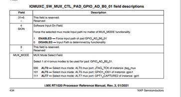

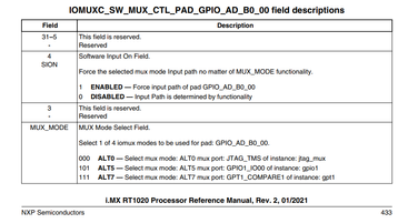

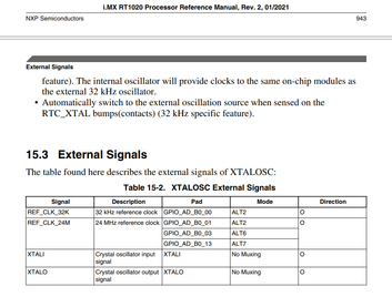

What pins can the 32KHZ & 24MHz xtal frequency be routed to for test purposes?
From the 'IMXRT1020RM' it mentions REF_CLK_32K & REF_CLK_24M can be routed to GPIO_AD_BO_00 and GPIO_AD_BO_01 respectively  (see extract below)
But when I checked the multiplexing section of the RM for the GPIO, there is no reference
to these multiplexing options (see below)
Can someone please clarify if this feature is supported or not?
