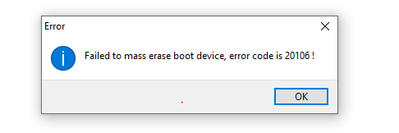

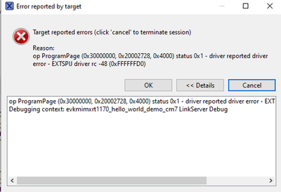

We are using imxrt1176 in one of our project. We had build 30 boards, but recently the below error is showing while flashing using SWD. We are using LPCLINK2 for programming & MCUXpresso Studio for the development. But we can flash the microcontroller using the internal RAM. We are using 512Mb W25Q512NWEIM for booting connected via FLexSPI. Initially these boards are working.

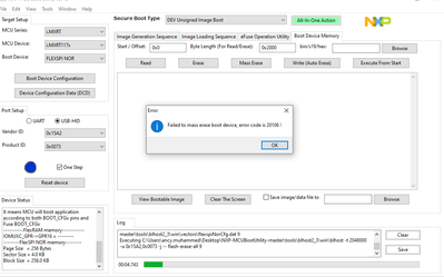

Attached the error showing while erasing using MCU Utility tool.

While doing the mass erase function in the utility tool the below error message is observed

We had tested the flexspi polling code. It is working fine in the failed boards. So we think that the flex spi interface is working fine.
