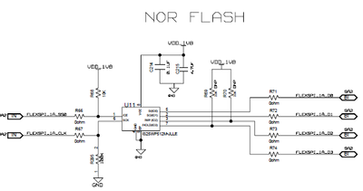

We are using imxrt1176 in one of our project. We had build 30 boards, but recently the below error is showing while flashing using SWD. We are using LPCLINK2 for programming & MCUXpresso Studio for the development. But we can flash the microcontroller using the internal RAM. We are using 512Mb W25Q512NWEIM for booting connected via FLexSPI. Initially these boards are working.
Attached the error showing while erasing using MCU Utility tool.

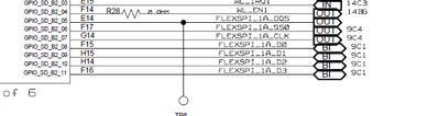

FlexSPI lines connection are shown below

Please make sure that QE is set. Additionally, could you share the Boot_CFG status you have on your pins? Are using fuses for boot_cfg?
Omar

The NOR flash we are using is W25Q512NWEIM. The part shown in the schematics is not correct. While running the flexSPI polling code the below data is shown in the terminal

Thank you for your information. The CFG configuration is correct but are you terminating the pins externally? If using efuses for this then it is ok to leave them NC.

We had tested the flexspi polling code. It is working fine in the failed boards. So we think that the flex spi interface is working fine.
