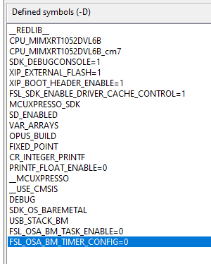

The programm of IMX RT1050 run on a serial flash IS25WP064 in XIP mode.
There is function that get data from this flash during init, as shown below :
AT_QUICKACCESS_SECTION_CODE(void ReadDataInFlash(uint32_t AddrTo,uint32_t AddrFrom,uint16_t Size))
uint8_t *ptTo=(uint8_t *)AddrTo;
uint8_t *ptFrom=(uint8_t *)(NOR_FLEXSPI_AMBA_BASE+(AddrFrom));
while(Size--)
*ptTo++ =*ptFrom++;
Sometimes when i modify the code anywhere i have a hardfault when running this function.
if i ad a line that change value of a variable (doesn't matter wich one) before calling this function the hardfault does not occure.
if in a next change hardfault ocures again , i just have to comment the line before the call of the function to suppress hardfault.
I suspect alignement in the code but i dont know how to solve this.
Here is the setting of my card:
Optimize (-O1)

YodaC
Hello Habib,
Thank you for the reply.
I am aware of this constraint, which is why I put all the codes that access the flash in RAM.
When everything goes well, it works all the time.
But sometimes when I change something in the code anywhere, flash reading doesn't work anymore.
The solution I found is to change the value of a variable (it doesn't matter which one) just before calling the read function.
If after a new modification in the code I can no longer read the flash, I just need to comment out the line which modifies the variable and it works again.
This is very annoying because I'm not sure if other parts of the code are affected.

I replicated the section code that presents intermittent issues in my RT1050-EVKB changing the SDK (version 2.16) example called "flexspi_nor_polling_transfer", but it worked fine all time. Since you mentioned that is a custom board, the issue could be a hardware issue by the DQS pin or the connections directly of the FLASH. Another cause of the issue could be the actions of the cache, you can try deactivating this.
Since I am unable to replicate the issue presented in your project, I cannot continue to assist you, it is unfortunately getting out of scope for community support.
