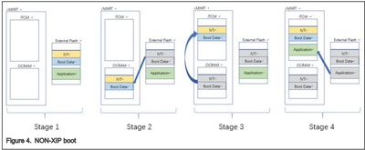

Moreover, there's an alternative solution for you, the ROM code can copy the bootable image to the RAM and starts up the application binary. It's a NON-XIP mode and the below figure shows the flow.
