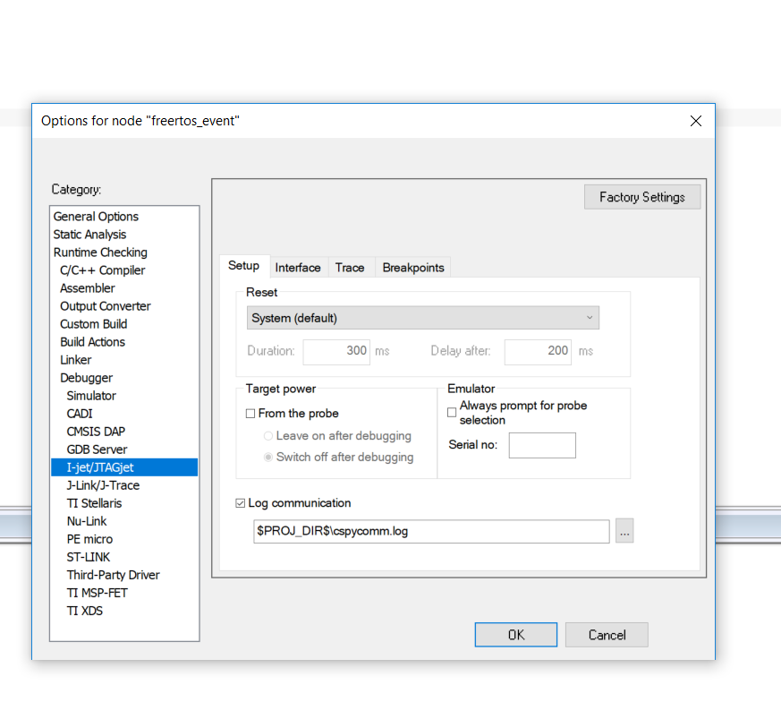

I m using i.mxrt1060 eval board with iar ijet jtag. When putting the board in SWD mode i do manage to debugging with no issues... but We need to use JTAG for many project based reasons. When switching to JTAG The following error appears in IAR(see long under).
I have removed the Jumpers J(47-50) and J44 to disconnect open SDA. Any thing else needed to be done in this case ?
Thu Mar 07, 2019 16:03:56: JTAG test failed - the TDO/SWDIO pin held permanently low.
I confirm this behavior when measuring JTAG_TDO is is always low....

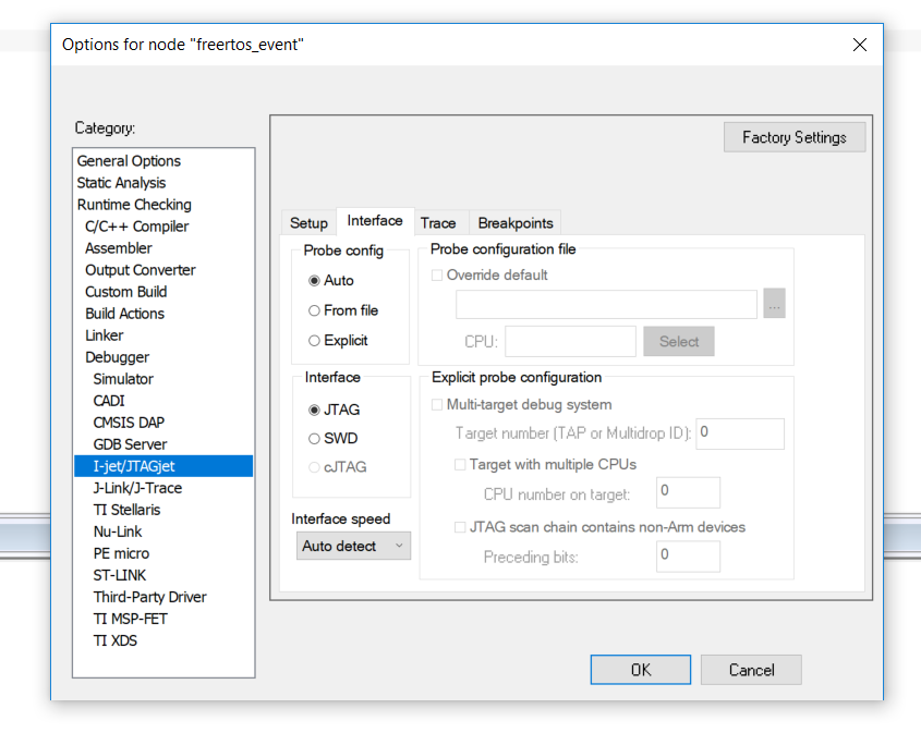

IAR configs are ijet :
reset -> Core
interface us set ti JTAG

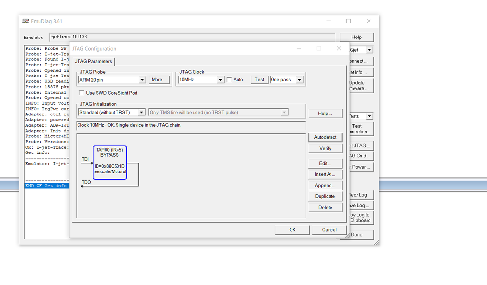

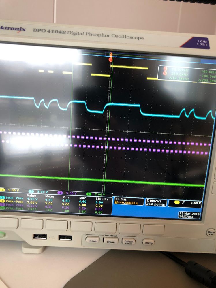

  • TDI had a capacitance (see picture under) to solve this I had to remove R323 and D18. Now the signal is the way it should be
After doing all this finally i can now read device ID which is 0x88C501D and the jtag clock is 12.5 MHz before this steps the clock managed 97KHz at best
Picture with Jtag id this is good news
Jtag_TDI had odd rise and fall due to capacitance in the line. This was correct by removing  remove R323 and D18 components.IMG_0195.jpg
Now i m getting the following Error "CPU status failed " and "cannot initialize DAP access" ...... Why m i getting the following error?
Can i program RT1060 device using jtag ?

My IAR configuration are the following :
  • Generate example project using MCUXpresso config Tools v5
  • QSPI Flash on the  MIMXRT1060 EVK Board with dip switches set to 0010 where 1 is SW7-3
