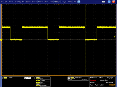

Hi community.
I need faster JPEG decoding on i.MX RT1170 EVK.
I measured the jpeg decoding time of the sample software sd_jpeg_cm7.
It uses 23msec to decode a 480x272 jpeg image, but I would like to speed this up.
The request requires about a 3x speedup. Do you have any ideas?
Best regards.

Hi @Ryo_Aoki ,
  Thank you for your interest in the NXP MIMXRT product, I would like to provide service for you.
  About the decoding, you can refer to this application note:
https://www.nxp.com/docs/en/application-note/AN12562.pdf
It contains some performance information.
  So,if you want to speed up, I think, you can copy the code to the internal TCM or OCRAM, it will faster than the external flash running result.
Wish it helps you!
