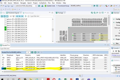

Dear I.mxRT1020 support,

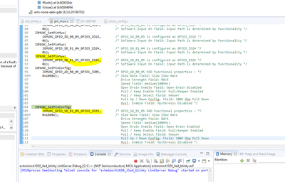

It seem that whenever I tried to enable the GPIO_SD_B1_05 in using the code generated by the PInmux tool, it would generate a hard fault imediately after executing the next line after
IOMUXC_SetPinConfig(
IOMUXC_GPIO_SD_B1_05_GPIO3_IO25, /* GPIO_SD_B1_05 PAD functional properties : */
0x18B0U);
I am using IDE version 11.2 and SDK2.8.

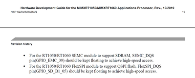

Also see this note from the hardware development guide

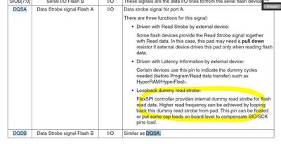

For QSPI Flash as XIP function, to achieve highest performance it is recommended to left FLEXSPI_A_DQS(GPIO_SD_B1_05)pin floating and config-sample clock source as 01-loopback from DQS pad mode to achieve max 133MHz Flexspi_clk, and change the function of this pin will make the application code crash.

-- The DQS pin design suggestion definitely applies to QSPI flash, as I remember that AE highlighted this design tip during the RT training.

I spoke with Anthony Huereca and also looked closer at Reference Manual.
It stated that the DQSA pin is only applicable for HyperRam/HyperFlash for dummy ready cycle.
For QSPI it doesn't apply. Can you confirm with designer to see that is the case?
If DQSA is not applicable for QSPI flash then we do have a conflict issue to resolve.
