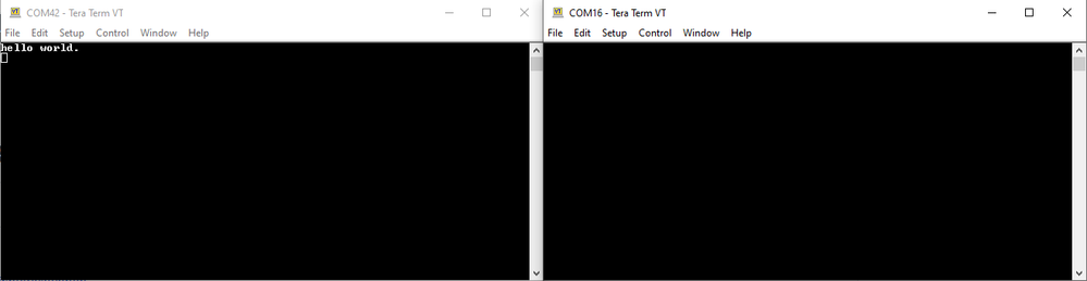

2,450 Views
patriciocohen
Hi @EdwinHz
As a last resort I tried with the Tera Term terminal you showed in the picture. And guess what? Now it works, but only with Tera Term. Why??
It doesn't work with YAT, Termite, Hercules and several others terminals. Please explain what could be happening, I can't find a reason.
Thank you.
Patricio
2,451 Views
patriciocohen
Hi @EdwinHz
Patricio here again. The mystery is solved.
Every terminal works once you set DTR (Data terminal Ready). It was driving me crazy, but now everything is clear.
Thanks for your help.
Patricio Cohen

EdwinHz
Hi @patriciocohen,
Are you certain you are following all of the steps shown on the readme.txt file inside of the doc folder of the project? Also, make sure you are reading the correct COM port. For example, here the PC is able to detect both the connection to the debugger (COM16) as well as the connection to the USB serial device (COM42):
But the "hello world" text comes from the USB serial device (COM42) not the J-Link (COM16):
Make sure you are using the USB connection.

2,458 Views
patriciocohen
Hi @EdwinHz
I tried even with my MIMXRT1060-EVK that I have here with no results. Could be a driver problem? The PC I'm using has Windows 10 and the VCOM installed driver is provided by Microsoft.
With the EVK I'm experiencing the same problem as with my custom board.
What is the program you are using for showing the USB devices you show in the picture?
Thank you.
Patricio
