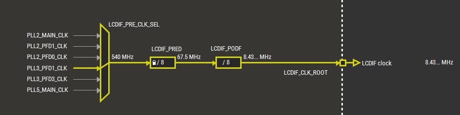

I used MCUXpresso configuration tool to set RT1060 LCDIF.

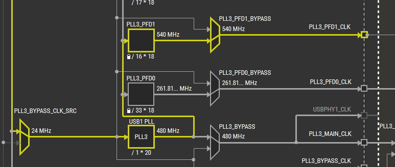

The following figure shows the clock configuration.LCDIF_PRE_CLK_SEL is PLL3_PFD1_CLK.
But the actual frame rate is incorrect.
I measured the lcd clock pin frequency with a oscilloscope, it was3.85718MHz.
The actual clock frequency didn't change when I adjusted div of PLL3_PFD1. It was still 3.85718MHz.

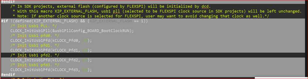

The pll3 code  generated by the configuration tool  was commented out.
I recommend that the IDE alert the user to avoid use pll3_pfd1 as LCDIF_CLK when XIP_EXTERNAL_FLASH == 1.

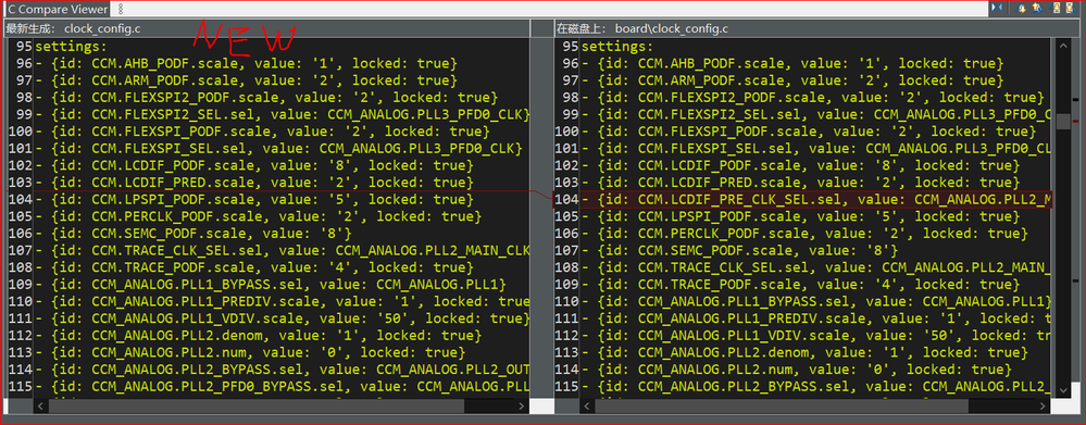

In addition, there may be a bug of MCUXpresso,
1.I configured PLL2_MAIN_CLK as LCDIF clock source. The CCM registers was correct. Thr actual LCD clock frequency is also correct.
2. I changed the LCDIF clk source as PLL3_PFD1_CLK. CCM_CSCDR2 was wrong.
3. I compared the new clock.c and the old clock.c. I found someting wrong.
