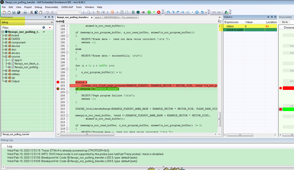

Hi Vasudhevan G ,
  Do you run this code:
SDK_2.7.0_EVK-MIMXRT1064\boards\evkmimxrt1064\driver_examples\flexspi\nor\polling_transfer
 directly?
  Do you download it to the internal RAM and run it?
  Do you modify some code, or just running it directly?
  This is my debug result:
   Please try the debug, and run it again.
Kerry
