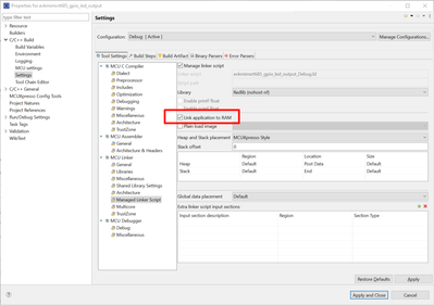

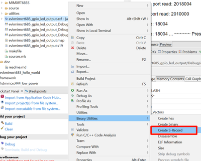

1. First, we need to generate an image that runs in RAM, not XIP. And convert it to S-Record type.
