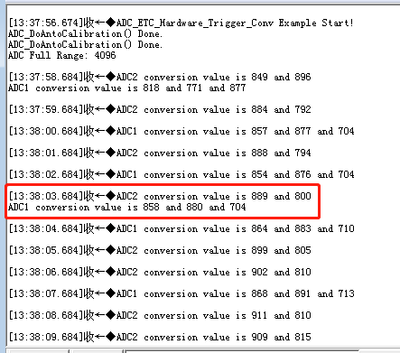

Thank you for your answer. When adding DMA function to the project, the result is different from what I expected.
I hope to trigger the ADC-ETC function within 1S, and then turn on the DMA transfer. In the DMA setting, I set up two channels to complete the transfer of ADC1 and ADC2 data respectively. When the conversion of ADC1 and ADC2 is completed, the DMA request is triggered.

What I want is the result in the red box of the picture. Two DMA requests are triggered within 1S, but sometimes only one DMA is triggered. can you help me?
6,476 Views

I want to trigger the ETC function once at the interval of 1 second in the PIT timer. In ETC, I set the ADC1 and ADC2 synchronous triggers, and the ADC converted data is transferred to the array through DMA. I set DMA channel 0 for ADC1 data and DMA channel 1 for ADC2 data. The current phenomenon is that sometimes only 1 DMA channel request is responded within 1 second.The adc_etc_hardware_trigger_conv.c file is my complete code
