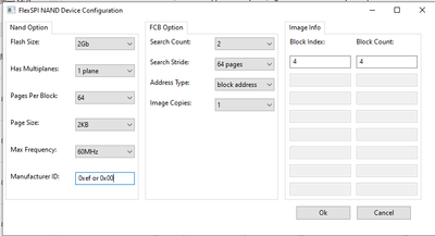

jay_heng
I have confirmed with Winbond guys that W25N02 has two planes actually, so we should try below setting
2,974 Views

jay_heng
 Winbond 1Gb device (W25N01) is well verified by NXP team, but for 2Gb device, I am not sure about it.
 I checked W25N02JW data sheet, it didn't seem to support multi-plane, but there are always two planes in 2Gb device of other vendors (MXIC, Micron…).
Anyway you can give a try by below settings:
3,028 Views
