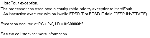

I am using IAR with no optimization enabled on a RT1020 evaluation board. I want to call e.g. FLEXSPI_SoftwareReset from fsl_flexspi with XIP enabled in my own code and have trouble with it.

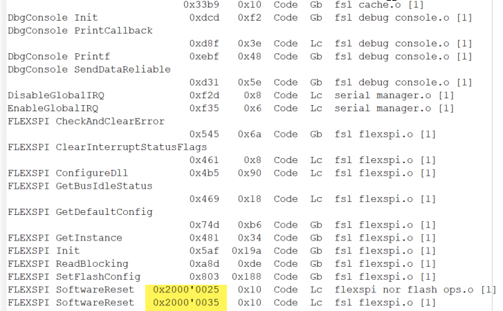

With no enabled optimization in IAR the function does not get inlined and I think the linker links the function call to the function placed in flash because if I copy the code inside the function call to my _ramfunc everything works fine.
The part of the map file without optimization looks like this

and will result in the HardFault

I have tried to replicate your issue by simply adding __ramfunc to FLEXSPI_SoftwareReset and it worked correctly with no hard fault. Please check my description below.
The only modification I made to the flexspi_nor_polling_transfer example was to modify FLEXSPI_SoftwareReset function as follows.
__ramfunc static inline void FLEXSPI_SoftwareReset(FLEXSPI_Type *base)
    base->MCR0 |= FLEXSPI_MCR0_SWRESET_MASK;
    while (0U != (base->MCR0 & FLEXSPI_MCR0_SWRESET_MASK))
I checked the map file and the function was relocated correctly in DTCM.
I debugged the example there was no hardfault. Could you please try this simply test to see if it works the same for you?

Yes it works the same for me. If I add __ramfunc to the NXP driver function it will be copied to internal RAM and not to a flash address.
I think it is not a good idea to change the NXP provided driver on my side, because if there are any SDK updates I will have to redo the changes. On the other side I don't think it is a good idea to just copy the whole fsl_flexspi.o object to RAM because it wastes some RAM.
