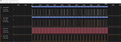

This is what a logic analyzer capture of the listed pins indicates:
so you can see that when command '6' is issued, the XBAR triggers J15-5 to clear and the SPI transfer starts, but does not complete all 25 bytes.  it appears that 25 dropping edges of J17-6 is measured (by the mirror on J17-4) till the dma channel 7 is started to set J17-5.
After this first cycle, no further SPI 3 traffic is measured, but the the number of dropping edges does match the number of bytes that should be transferred.

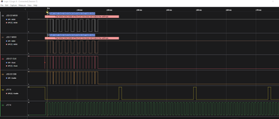

To show results that I measure when I test command '5':
I can see J17-5 does clear then set again on each dropping edge of J17-6:
zoom in on one of the transfers:
So I am confident that the XBAR triggering the GPIO pins changing states does work.
